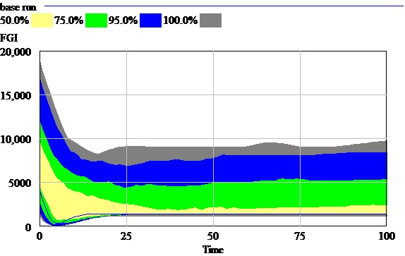

Please explain me what is the colour indicating in the attached sensitivity graph
I am not able to analyse this graph can any one explain to me
ash color reduced from 20000 to 10000 and became straight and also that appears at 0

When doing a sensitivity run, Vensim will run the model lots of times and change the parameters. What this graph shows is that of all the runs, 50% of them were within the yellow section, 75% within the green, 90% within the blue and 100% within the grey.

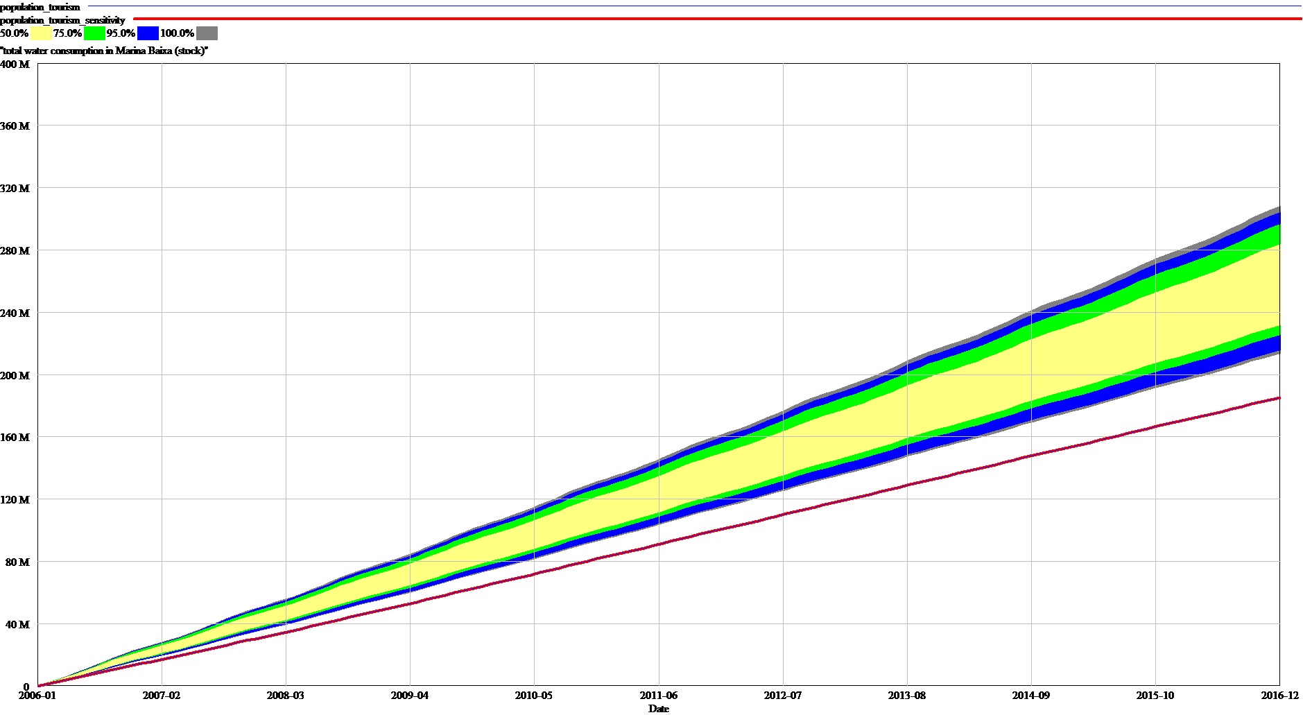

Re: sensitivity graphs
I attach a sensitivity graph.
What is the red line tells us?
- sensitivity_graph_submitted.jpg (250.72 KiB) Viewed 9465 times

You will need to upload the model and associated files if you need help with this.
I believe the red line shows an output based on parameters before I started sensitivity analysis.
Is that correct?
How do I export all values 50%, 75% and so on output values?
I can export a sensitivity graph but not any values.
Is that correct?
