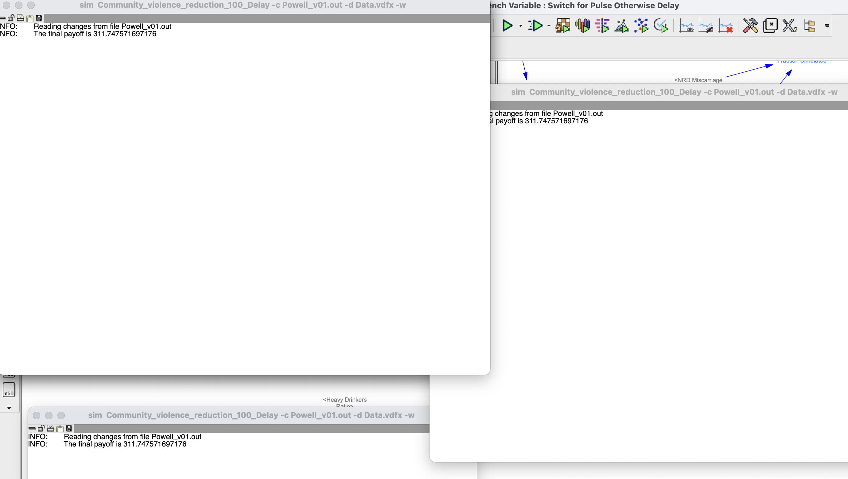

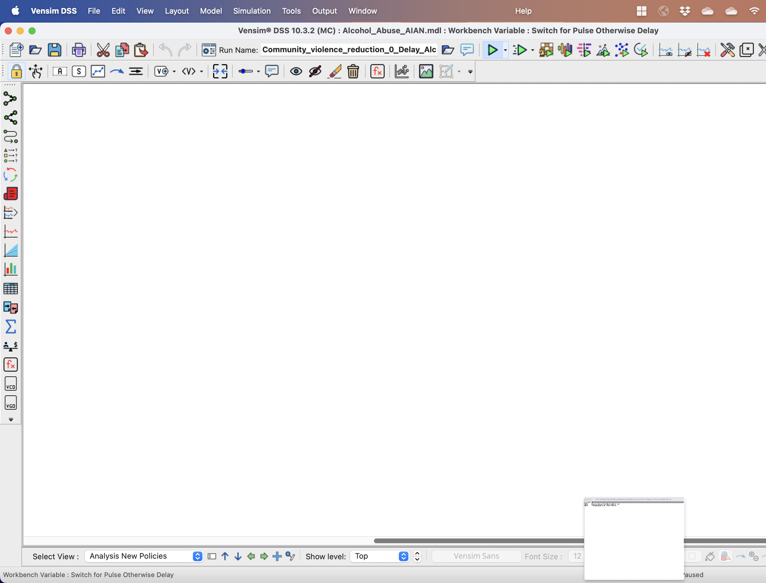

As someone who goes back and forth between different inputs and datasets when working on a model, I appreciate the fact that this message pops up every time I run the model. In this way, I can make sure that I've run what I intended to do. But the window management is done so poorly, and it has been an issue for a long time.
Screenshot 2025-07-05 at 10.15.53 PM.png (971.68 KiB) Viewed 6860 times

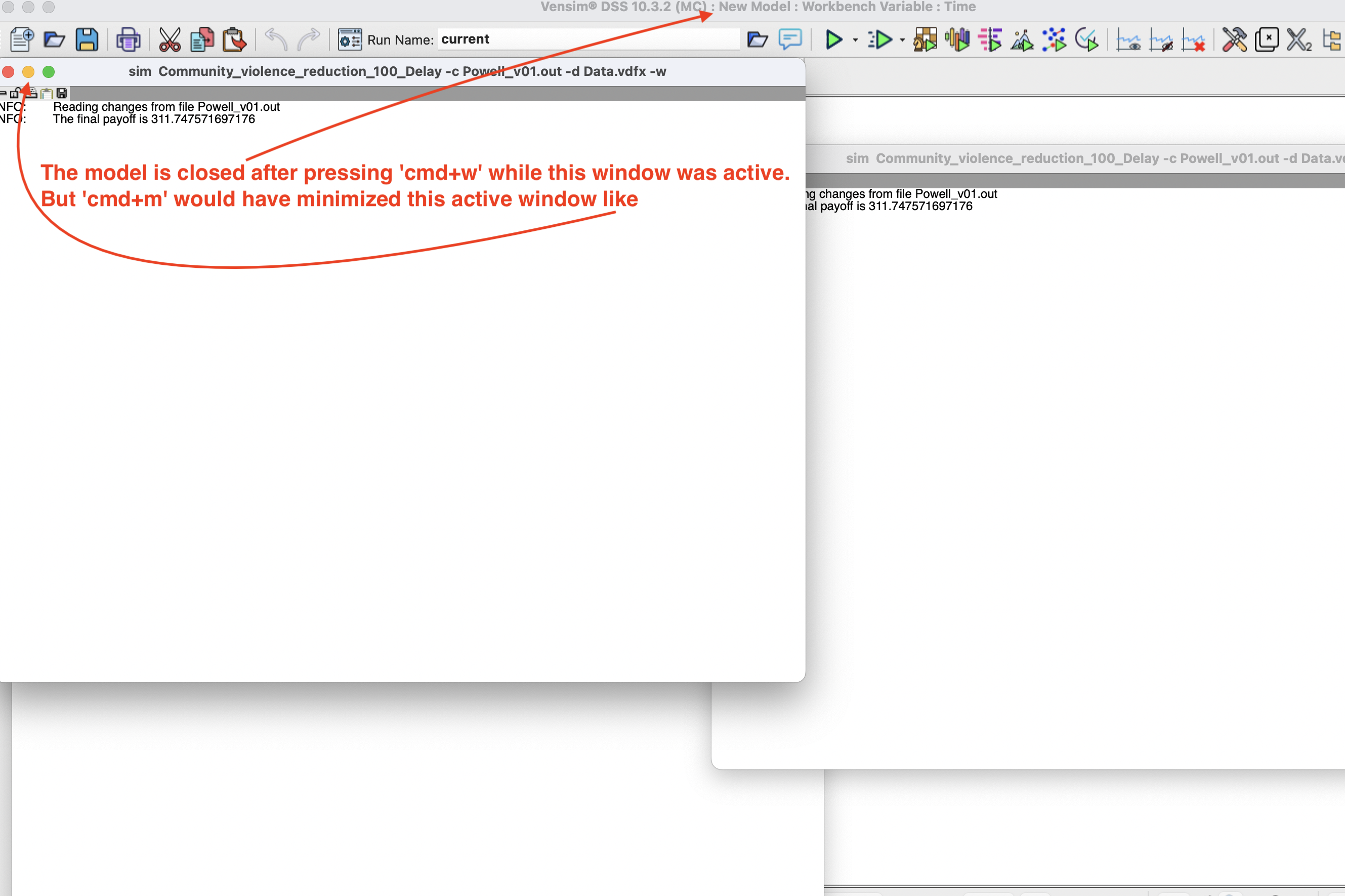

First, the window is inactive after it pops up. So if I press cmd + m or cmd + w, the action is applied to the main window and all the information remain there fully stuck to the front.
Second, if you click on the sim info window and activate it, cmd + w closes the model in the main window (!) and leaves these tiny windows open, and cmd + m minimizes the simulation information window without touching the model window.
Screenshot 2025-07-05 at 10.41.02 PM.png (1.13 MiB) Viewed 6860 times

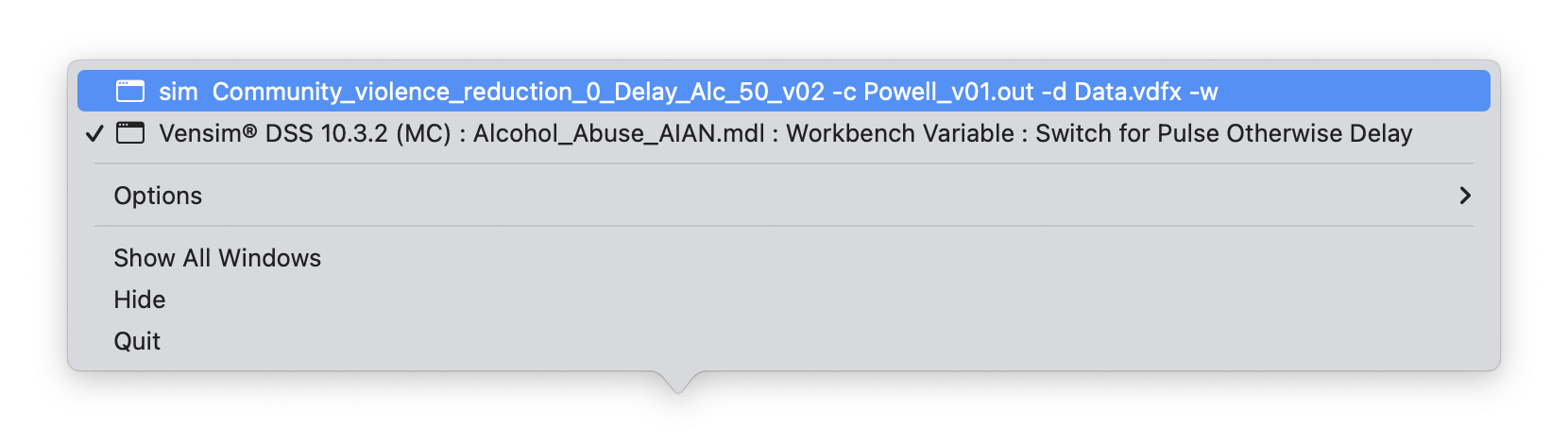

They're so sticky that none of these work
Screenshot 2025-07-05 at 10.48.43 PM.png (641.29 KiB) Viewed 6858 times
Screenshot 2025-07-05 at 10.49.01 PM.png (443.06 KiB) Viewed 6858 times

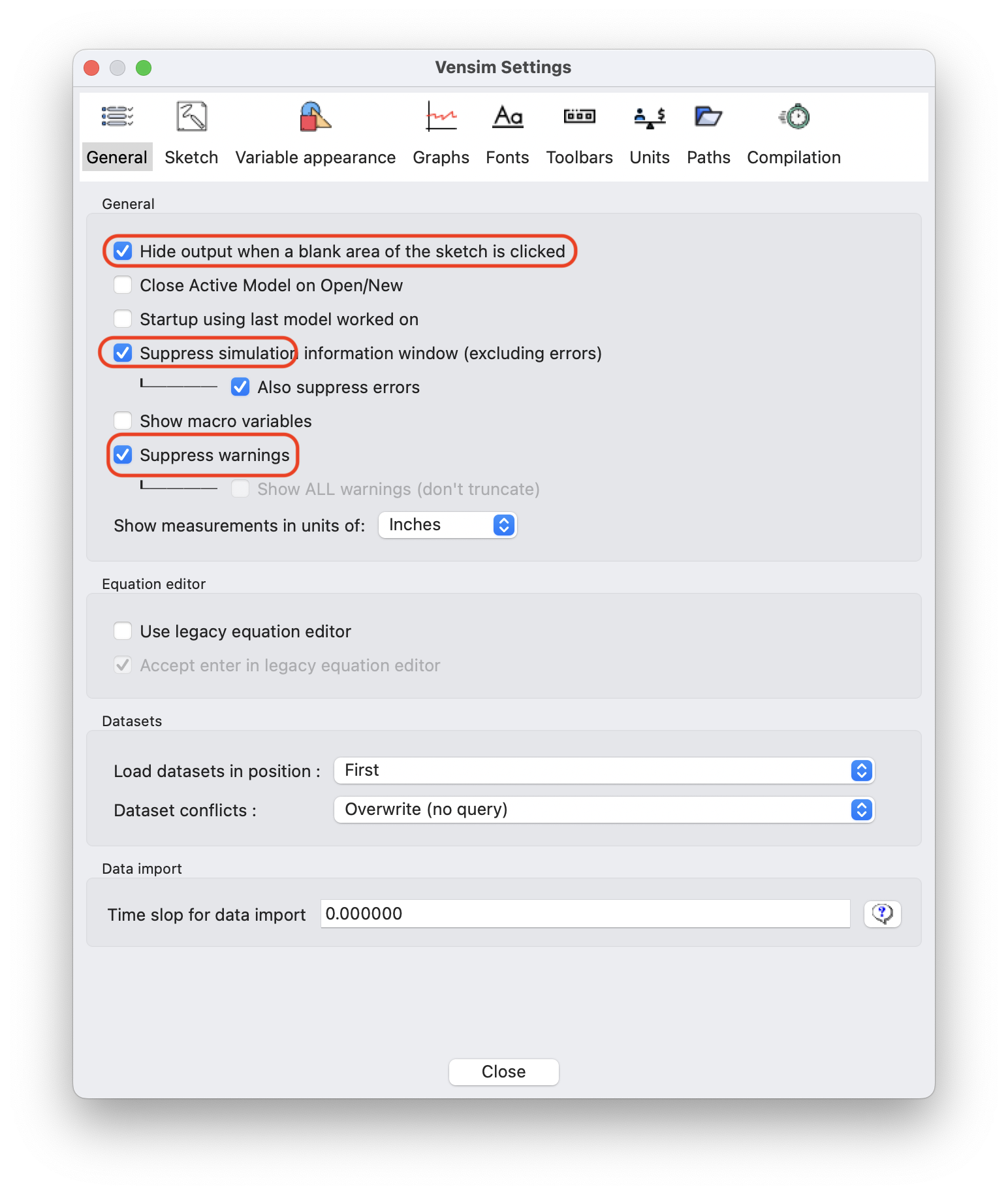

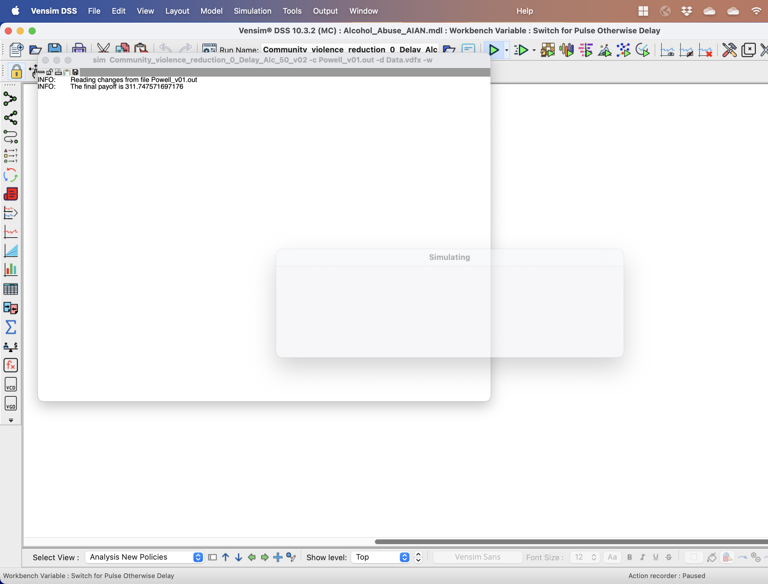

ChatGPT helped me write a helper to use Accessibility “AXObserver” API to receive window-created notifications so that whenever this window pops up the OS automatically minimizes it. it's a swift app that you can compile with terminal command line tool and run it in the background, which uses less than 0.1% cpu:
Screenshot 2025-07-06 at 11.53.02 AM.png (1.5 MiB) Viewed 6804 times
Screenshot 2025-07-06 at 11.53.05 AM.png (1.33 MiB) Viewed 6804 times
Screenshot 2025-07-06 at 11.52.55 AM.png (1.15 MiB) Viewed 6804 times

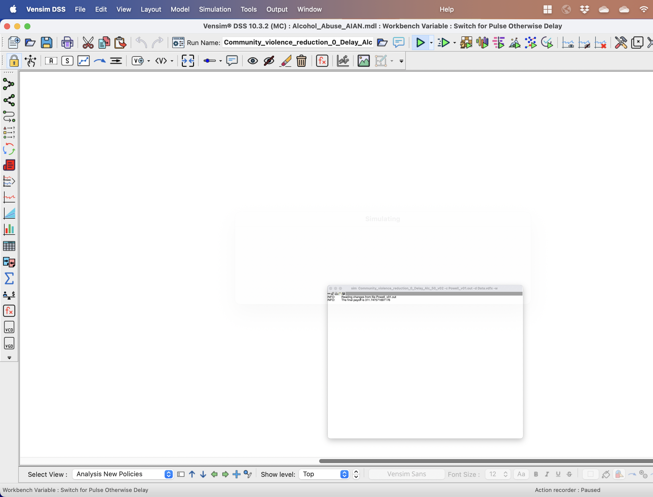

Also, the app minimizes any Vensim related window that starts with 'sim ', which is a characteristic of those simulation windows. I guess it won't minimize the models even if they start with 'sim' because those windows start with 'Vensim'
Screenshot 2025-07-06 at 11.13.27 AM.png (126.26 KiB) Viewed 6802 times
