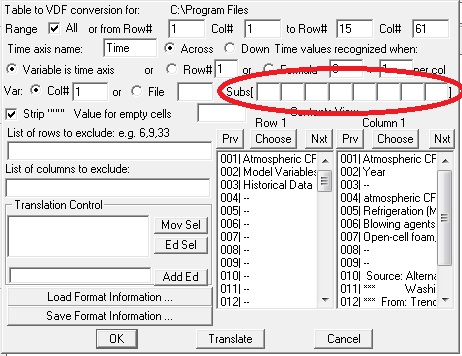

(2a) Specifically, when I import from Excel, in the Table to Vdf Conversion box I see an area for subscripts, but don't know how to use this or where to find a reference explaining it. (See image1 attached) Help? How to format the data and configure the conversion?
(2b) Is my subscript limited to 8 elements? If so, the best way to load a variable subscripted by more than 8 elements?
Ignore this. It's easier to both read and work with if you just list them as I have above (the documentation for this is at
http://www.vensim.com/documentation/ind ... ?23465.htm)
No. You can only have 8 subscript ranges in Vensim, but each range can have many elements.
