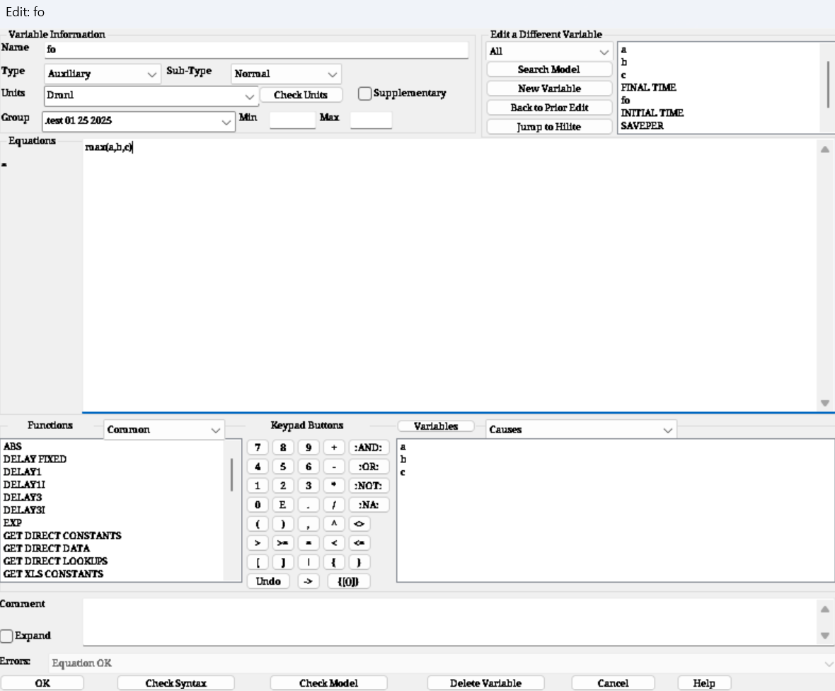

I downloaded the latest version (10.2?) of PLE for my dissertation to my new PC (Windows).
I see that the equation editor is blurred. Is that normal? Or is it because of my PC?
Also, the max and min functions are resulting in errors when more than two values are used.

I have attached a snapshot of the blur problem.

Re: Blurred view and max/min
Looks like a font problem. You could try changing fonts in Tools>Options>Fonts.
Definitely a font issue. Try courier new or segoe ui.
My colleague recently found out that this is related to different display scaling settings (125%, 150% etc.) in a multi monitor setup. If I understood correctly, it behaves like that:
1. model opened on display A (lets say a 4k monitor set to 150% scaling)
2. Vensim window is dragged to display B (Full HD Monitor with 100% scaling)
3. equation editor will still open on monitor A since the model was opened here initially, but will now downscale the opened popup.
